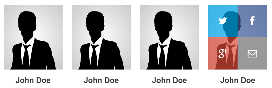

Hover effect is gone after changing the name of the article 10 years 11 months ago #1667
  • Martin de Graaf
  • Martin de Graaf's Avatar
  • Posts: 32
I have a few questions about the very nice hover effect for contact in the Vina_Bakery template. I was looking at the code to fill in the links to Facebook, Twitter, etc. First of all I changed the name of the article but after changing and saving the name, the hover effect was gone. I tried to find the code for the hover effect but could not find it.
So my first question is where I can make it work again and my second question is where I can put the code for linking to the social media.
This picture shows how the hover supposed to be working:
This picture shows how the hover stopped working and the social contact icons are underneath the picture:
Last Edit: 10 years 11 months ago by Martin de Graaf.

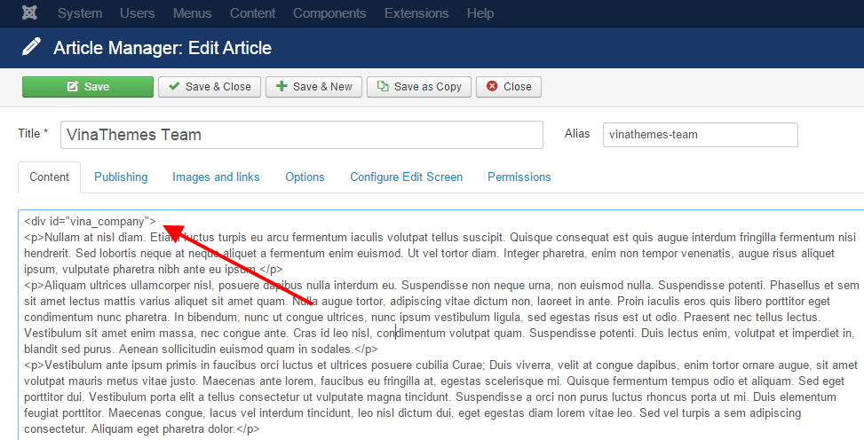

Hover effect is gone after changing the name of the article 10 years 11 months ago #1684
@Martin de Graaf : You need 1 div sheathed your post:
<div id="vina_company">
The following user(s) said Thank You: Martin de Graaf

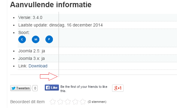

Vina Bakery II 10 years 10 months ago #1784
  • Martin de Graaf
  • Posts: 32
When I am using the extra fields in K2, they are NOT adjust. It seems that the code in the template override these functionality. Can you help me find the code where I must change that, so that the extra fields and nicely underneath adjust to each other. See the picture below:
Vina Bakery II 10 years 10 months ago #1788
@ Martin de Graaf,
You can edit code at file item.php : ROOT/templates/YOUR-TEMPLATE/html/com_k2/default/item.php :
 <?php if($this->item->params->get('itemExtraFields') && count($this->item->extra_fields)): ?>
	  <!-- Item extra fields -->
	  <div class="itemExtraFields">
	  	<h3><?php echo JText::_('K2_ADDITIONAL_INFO'); ?></h3>
	  	<ul>
			<?php foreach ($this->item->extra_fields as $key=>$extraField): ?>
			<?php if($extraField->value != ''): ?>
			<li class="<?php echo ($key%2) ? "odd" : "even"; ?> type<?php echo ucfirst($extraField->type); ?> group<?php echo $extraField->group; ?>">
				<?php if($extraField->type == 'header'): ?>
				<h4 class="itemExtraFieldsHeader"><?php echo $extraField->name; ?></h4>
				<?php else: ?>
				<span class="itemExtraFieldsLabel"><?php echo $extraField->name; ?>:</span>
				<span class="itemExtraFieldsValue"><?php echo $extraField->value; ?></span>
				<?php endif; ?>
			</li>
			<?php endif; ?>
			<?php endforeach; ?>
			</ul>
	    <div class="clr"></div>
	  </div>
	  <?php endif; ?>
And style them by override css : div.itemExtraFields, .itemExtraFieldsHeader, .itemExtraFieldsLabel , .itemExtraFieldsValue...
