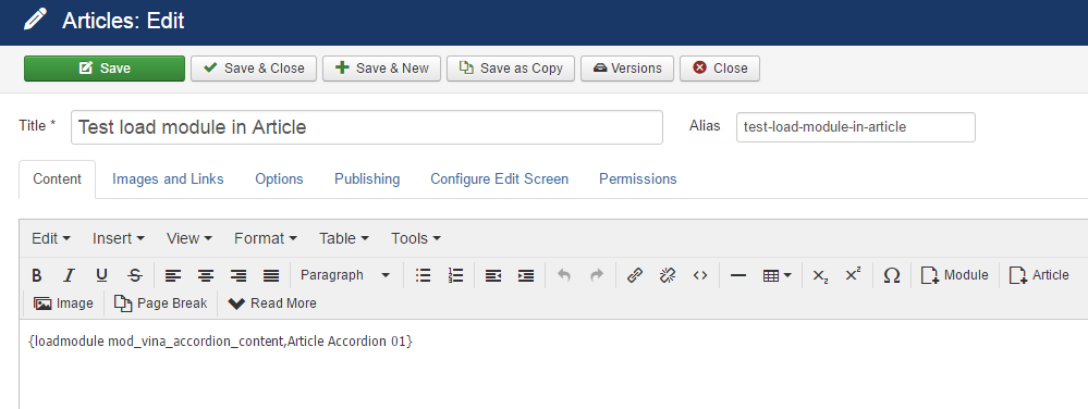

I'm trying to do the same : loading a "Vina Article Accordion" module inside an article with :
{loadmodule mod_vina_accordion_content,Vina Article Accordion}
It does not correctly works : it displays partially, but all accordion's items are opened and no action / accordion effect is possible on the items.
If I load the same module the regular way in a regular position (ex: breadcrumbs) the accordion displays ok with actions/accordion effect ok on all items.
It's just like if the module does not load everything if inside an article :-(
How can I fix this please ?
Using Vina Article Accordion on New Article Page 9 years 3 months ago #4101
Hello Oziolab SARL,
I have tested load module in Article, it works well :
Check result : joomla.vinagecko.net/e/79-joomla-3-modul...ad-module-in-article
Could you give me admin account, then i can check it for you?

Using Vina Article Accordion on New Article Page 9 years 3 months ago #4128
What template's name that you're using?
