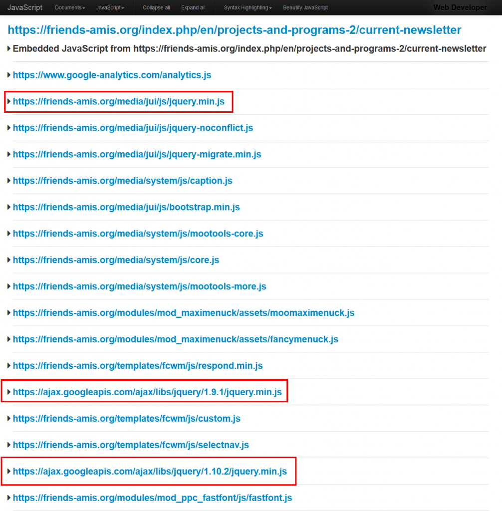

I see from searching that other people have had the problem with no open/close icons displaying. I haven't seen a solution.
The article displaying at the bottom of the page when clicking read more is an issue too.
Please have a look:
friends-amis.org/index.php/en/projects-a...2/current-newsletter
Last Edit: 10 years 11 months ago by Joe Bedford.
Vina Article Accordion 10 years 11 months ago #1504
@Joe Bedford: I've checked your website and see you have a problem with jQuery conflict. (Your website is loading 3 jQuery library)
You need solve this problem, then you will see our module work like live demo.
PS: you can install this plugin to solve the problem with jQuery conflict: extensions.joomla.org/extension/jquery-easy

I installed jquery and have played with some of the parameters. It looks like it's working but there has been no change in the behaviour of Article Accordion (no open/close icons and articles displaying at the bottom of the page. This is output from the jquery log. Is there a special parameter I'm supposed to set?
